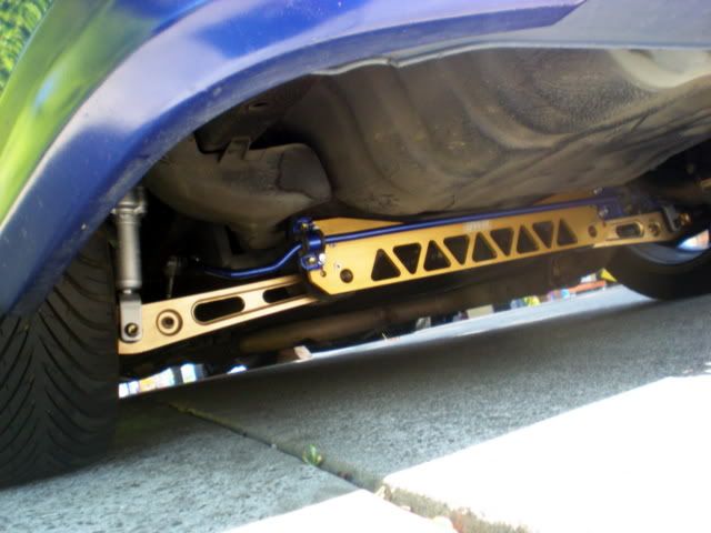

    alright this mite be a stupid question so dont bash me for this lol
    but i just bought a beaks bar for my car and i wanna put it on but i already got gold skunk2 LCA's and a Polished BWR Sub Brace......will it fit with the sub brace on or no?

      ive seen it with an ASR brace but ive never seen it with a BWR brace like this one

          the holes are still there
            yeah but if u look at the BWR brace the bolt looks like its behind the brace

              never mind guess this pic answers my question lol

                      you might need longer bolts thats all.
                        yeah im 98% sure imma need a longer bolt but aye i just want it on lol i been dying to get a beaks bar for a while

                          I dont think you will be able to get aircraft grade bolts at home depot. Remember although the subframe brace is cool and the beaks bar is cool it also serves a purpose( although you dont need both but hey shit happens) What i was getting to is you dont want cheap grade bolts in there one good pot hole and the bolt breaks and bad stuff happens.

                            true yur rite about that even tho i only want both for the look i dont wanna use a cheap bolt for it........any idea's where i can get a strong enough bolt?

                              I used lower starter bolts off of a bseries its the longer of the 2 nd ur good just Google or jhpusa sells the beaks asr longer bolt kit for $25 shipped on eBaynd Lmfao at those 2 pix where there is a stock sway bar added to a subframe the subframe is ment if u want s bigger swaybar but they still used the stock also that other one the bpipe is chilling on the pavement
